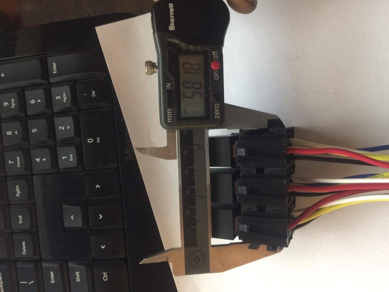

Hier mal das fertige Produkt:
Folgende Infos von Ihm direkt:
Mines custom designed and built. Works with factory sensors but you do have to splice the speed output from the gearbox. Uses a knob to select the speed from 10-120km for activation. Also uses an internal potentiometer to change threshold of the retract...so you have have it down for instance and have 5km difference in speed and won't go up down up down.
I can also customize it in that way, that it is plug and play with the oem active spoiler ecu and controlable from the oem active spoiler switches with that "auto off" and "down button"
Wenn Ihr also Interesse habt kontaktiert am besten Andrew direkt über Facebook unter folgendem Profil:

Weitere Infos von Andrew:
So what my controller will do is replace the oem one completely. It will have the male plug that will bolt directly into the existing plug. 3 mini relays will sit on top of the box I showed you previously. So it will plug in and work.
you can choose how it works, currently it has up,down and auto mode with the auto mode speed set by a pot mounted somewhere you choose.
